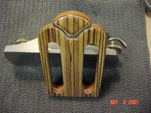

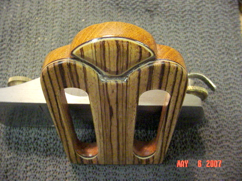

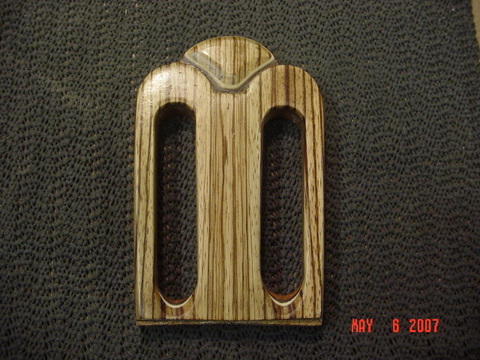

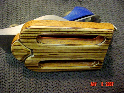

Oh Well, Here are some pics of my prototype headstock design which I made from scraps after I cut out my back.  I just wanted to see if I could do what I had in my mind.  The final product is not high quality, since I started from pieces yesterday.  Did the joins, planed down to about 1.4mm, cut it out, glued up the layers, bored and filed out the slots, sanded and finished with about 5 - 6 coats of the Zinsser spray shellac.  Suggestions are welcome.

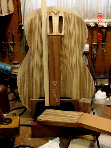

The last one puts it in perspective as to where I am in my progress.
Thanks for looking.

The crown was part of the veneer, but when carved down, ended up looking like a separate piece.  I use a marking knife to get clean cuts on the inside curves to get something to carve to.  The whole thing is too short to use, but I didn't know if it would work like I had planned.  Now, I have to do it for real.  That makes me nervous.

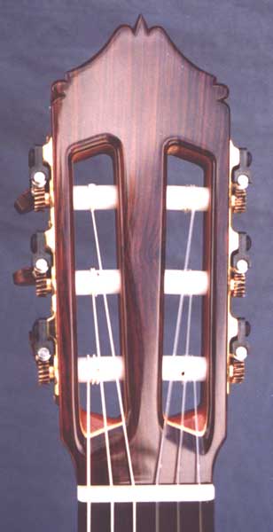

Really cool, I like it when people think outside the box. Is the 1st pic the same headstock as the others? In the 1st pic the outside edges look parallel, however I can see the angles better in the other pics. Maybe it's just the photos. You know what else might look cool is if you can file your ramps in the slots to match your angle of the top of the headstock, kinda like the pic below, but in the opposite direction.
Good start, I like it!

[QUOTE=John Elshaw] Is the 1st pic the same headstock as the others? In the 1st pic the outside edges look parallel, however I can see the angles better in the other pics. Maybe it's just the photos. You know what else might look cool is if you can file your ramps in the slots to match your angle of the top of the headstock, kinda like the pic below, but in the opposite direction.
Good start, I like it![/QUOTE]
Thanks John,
Like I said, it was a test made from scrap.  It is slanted properly for a headstock, but it is hard to see because of the angle of the pics.  It also doesn't show much because the thing is about 2 1/2 inches shorter than a regular headstock.  The ramps are also shortened for the same reason.  They were sort of an afterthought to see how they would look.  In the design, the slots are centered in the outside humps in the head, and slant in with the edges.  I am thinking of using a 1/2" gouge, and beveling the flat edge into a rounded ramp in the center below the crown.  It was an idea I had while cleaning up and sharpening some gouges that had been neglected for years.

Waddy, you've got something quite interesting going on here. There's a design clash, though, between the bottom "point" of the carved section and the shoulders that frame it. You have a flat area fighting with the roundness all around it. There are a couple of ways I can think of to harmonize it:
Enlarge the radius of the shoulders above your slots, and continue the curve to the center line, creating a "V" shape. Then carve the bottom of the center section to fit the "V". It would make everything nice and round.
Another option might be to radius the bottom of the center section, perhaps matching its top, to give it more of an "eye" shape. This might visually separate it too much from the rest of the headstock, though.
I'd suggest trying it all on paper first, using true radii of circles. Grab an eraser and anything circular--coins, washers--and/or a compass and experiment.
The proportion of the center carve to the rest of the headstock is hard to judge because of the short prototype; but you might want to make that center section larger or taller so it becomes the most prominent part of the headstock. A good example is the crown of John's headstock shown above. Right now, your's has a bit of a "shrugging man" look.
This is all just my humble opinion, so take it for what it's worth. In the end it's your satisfaction that counts the most.

Thanks, I think you are right.  A template and router would make the job much less daunting, and easier to repeat.  I really haven't gotten to many jigs yet.  They will come along with my experience and experimentation.
Carlton:
I think you are right about the little flat fighting the other round surfaces.  I think I mentioned above that I'm going to take a 1/2" gouge and put a curve tying the two outside humps together at that point in the middle.  I'm going to cut it flat first and see what happens, then I'm going to ramp it a little to see how it looks with the other ramps.
You may also be right about the center needing to be taller.  I'll look again after dealing with the center.

OK, I did some quick changes just to see.  Shot them wet to get an idea
of how they would look.
1.  Just curved the bottom of the join between the two outside humps in the center below the crown.
2. In this one, ramped the center slightly, and softened the edges of the two outside humps to more closely resemble the crown.
In both of these, In a new piece, I would try to bring the lower point of the crown down closer to the lower center curve.
Ideas?
